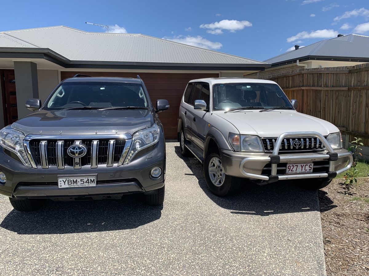

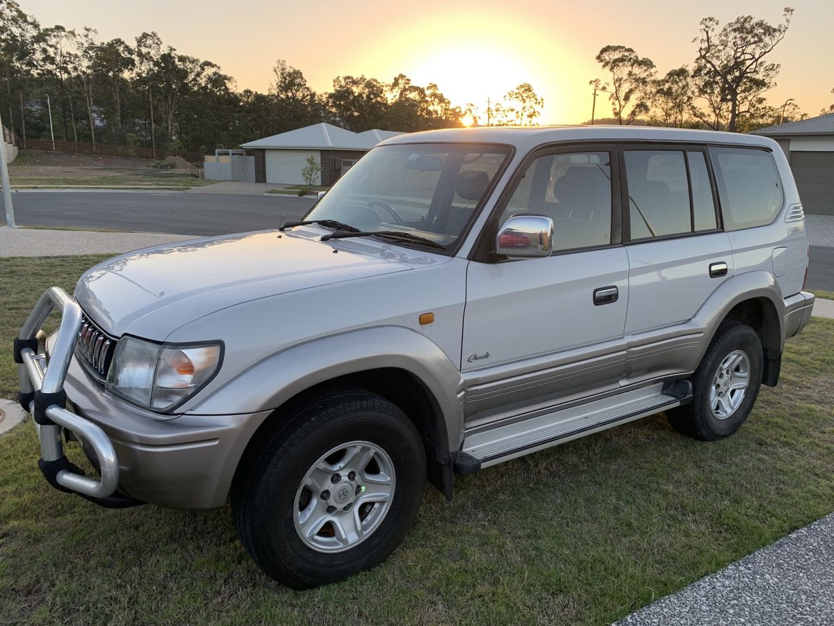

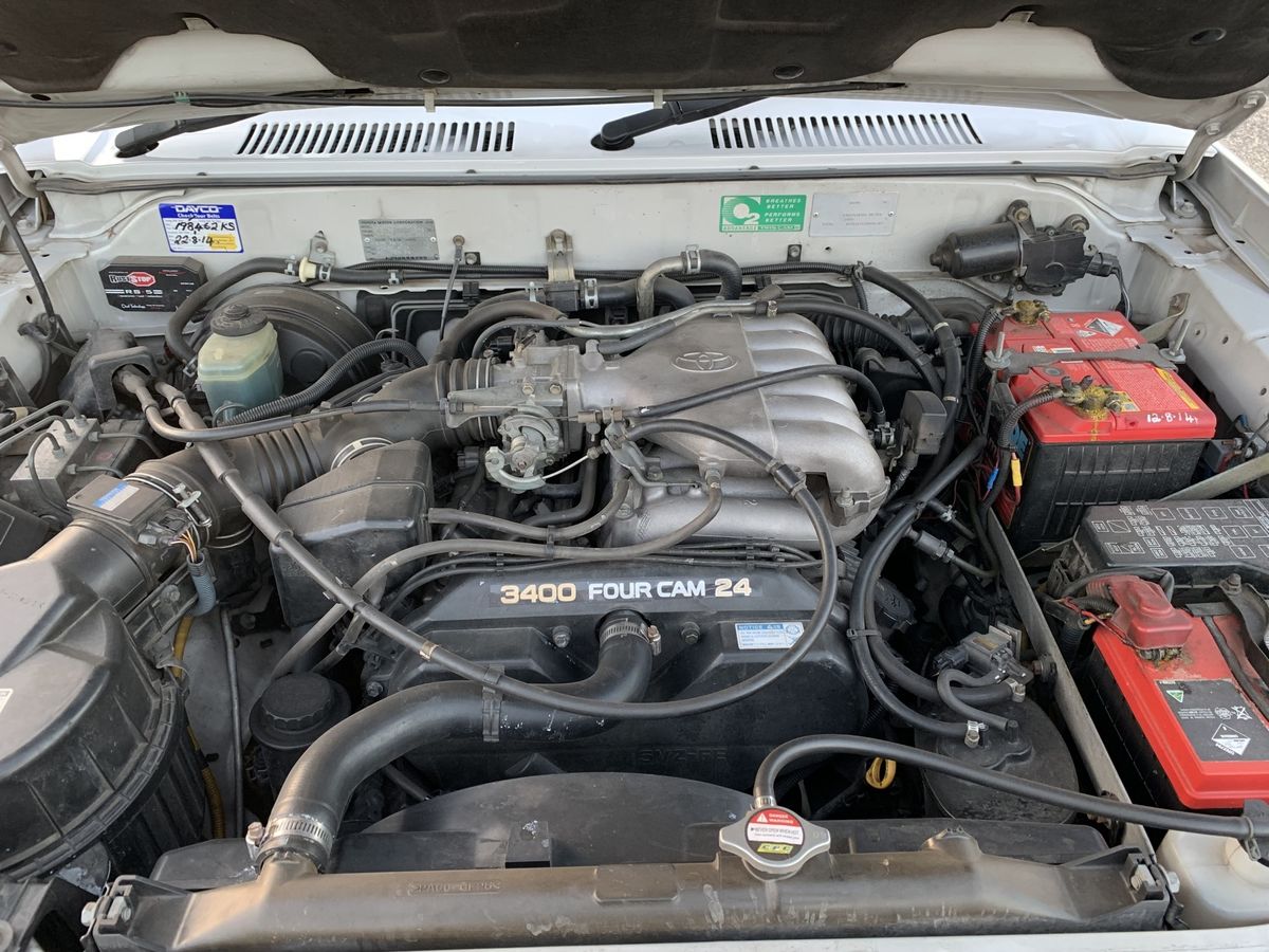

After owning both a petrol 120 Grande and a 150 Update Kakadu I got sick of dicky electronics and gizmos and went old school, bought my 98 V6 Grande with no mods back in Dec 2018. 235,000km and it great condition for its age.
The Day I bought it:

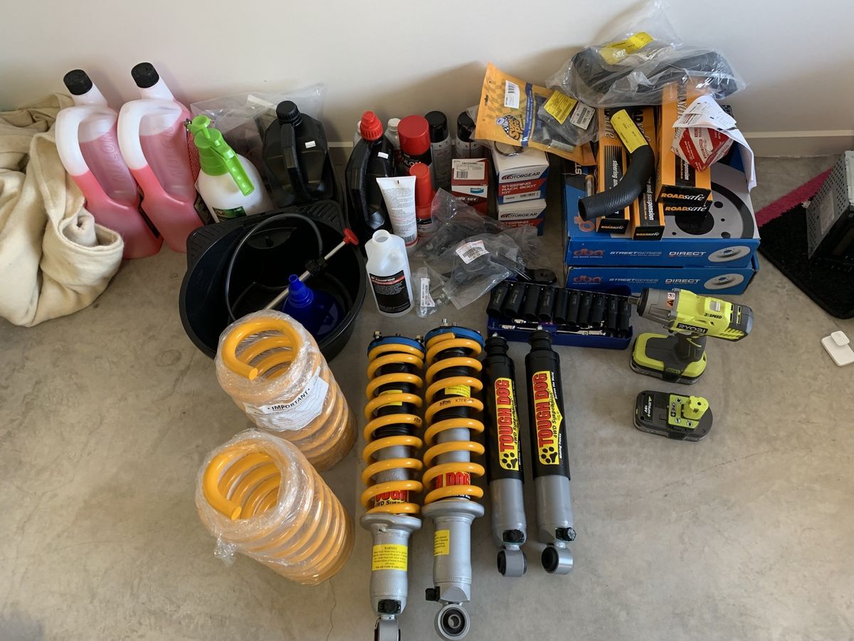

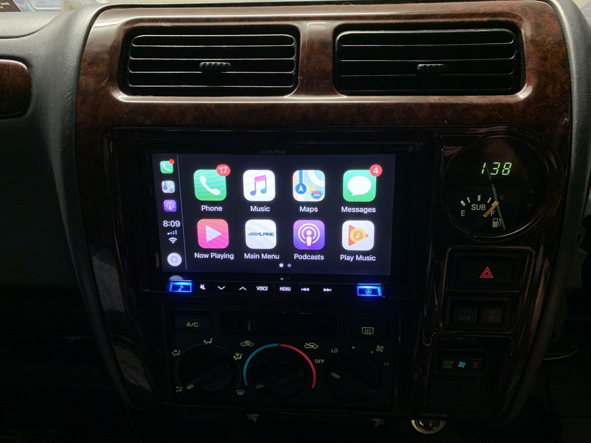

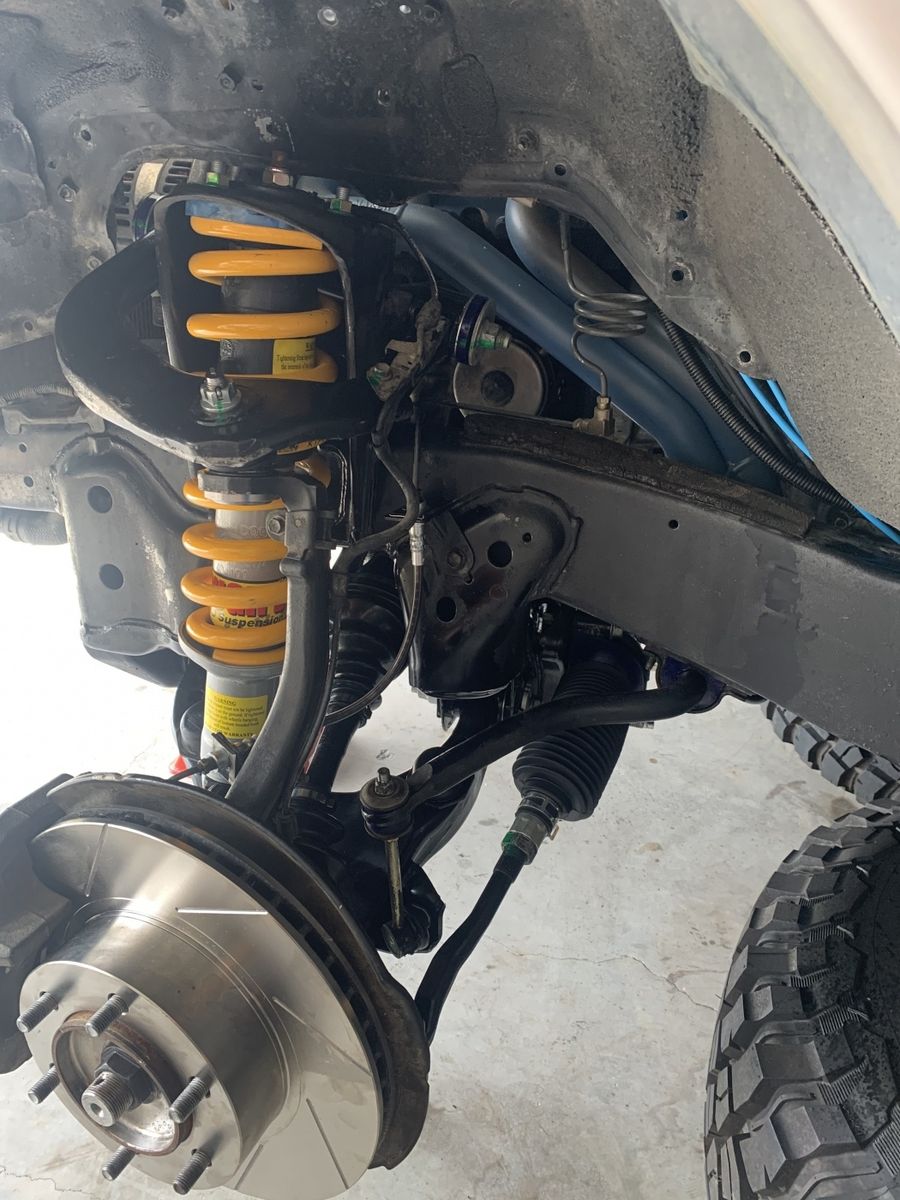

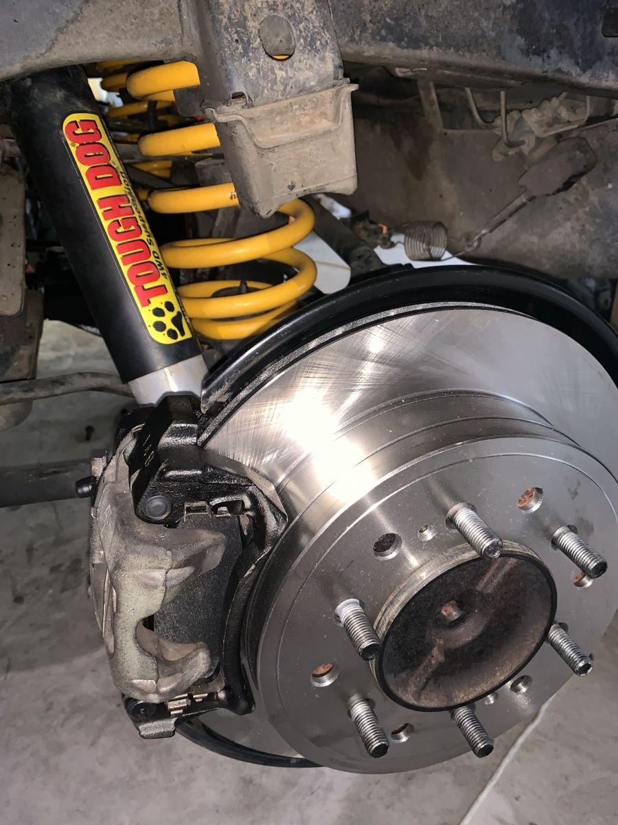

Next was to fix the usual oil leaks from the rockers and install a set of tough dog adjustable shocks,40mm lift and Alpine Carplay headunit with reverse camera.![]

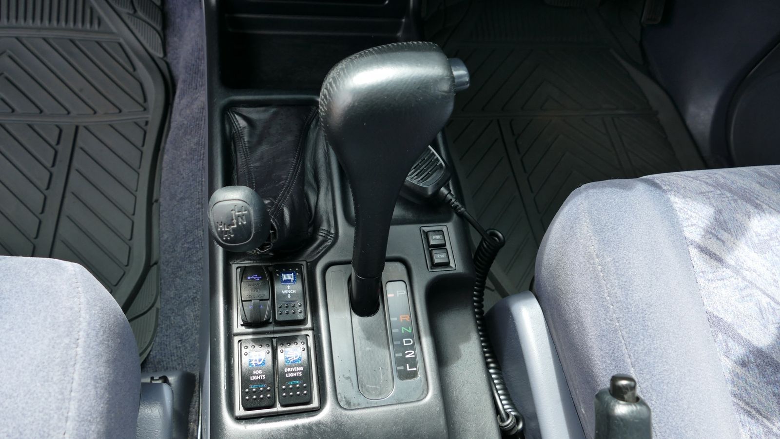

I pretty much left it like this for 12 months until I wanted more power and better/bigger tyres. Spent a few months looking for a supercharger when I came across a 2001 GXL in my suburb kitted out with Supercharger conversion, Dual lockers, pacemakers and Recaro seats for $7k.

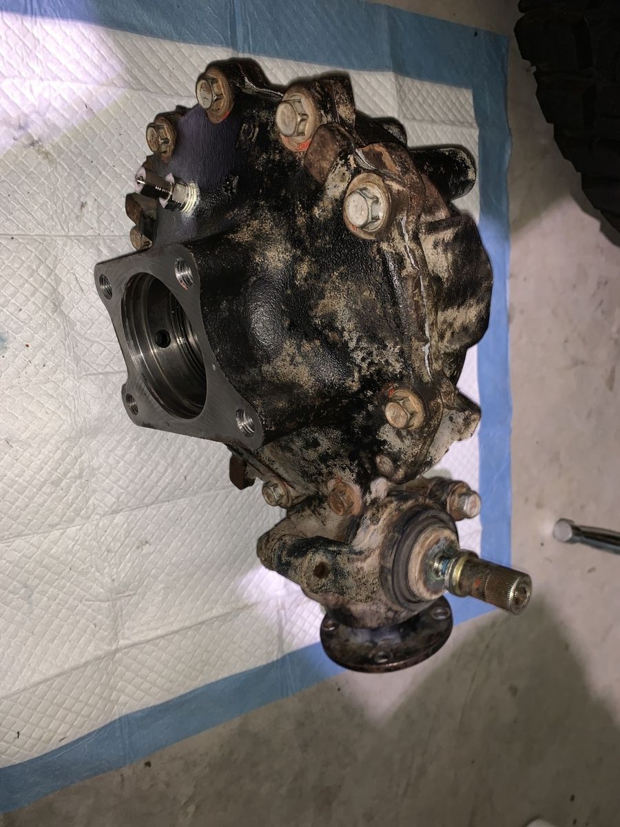

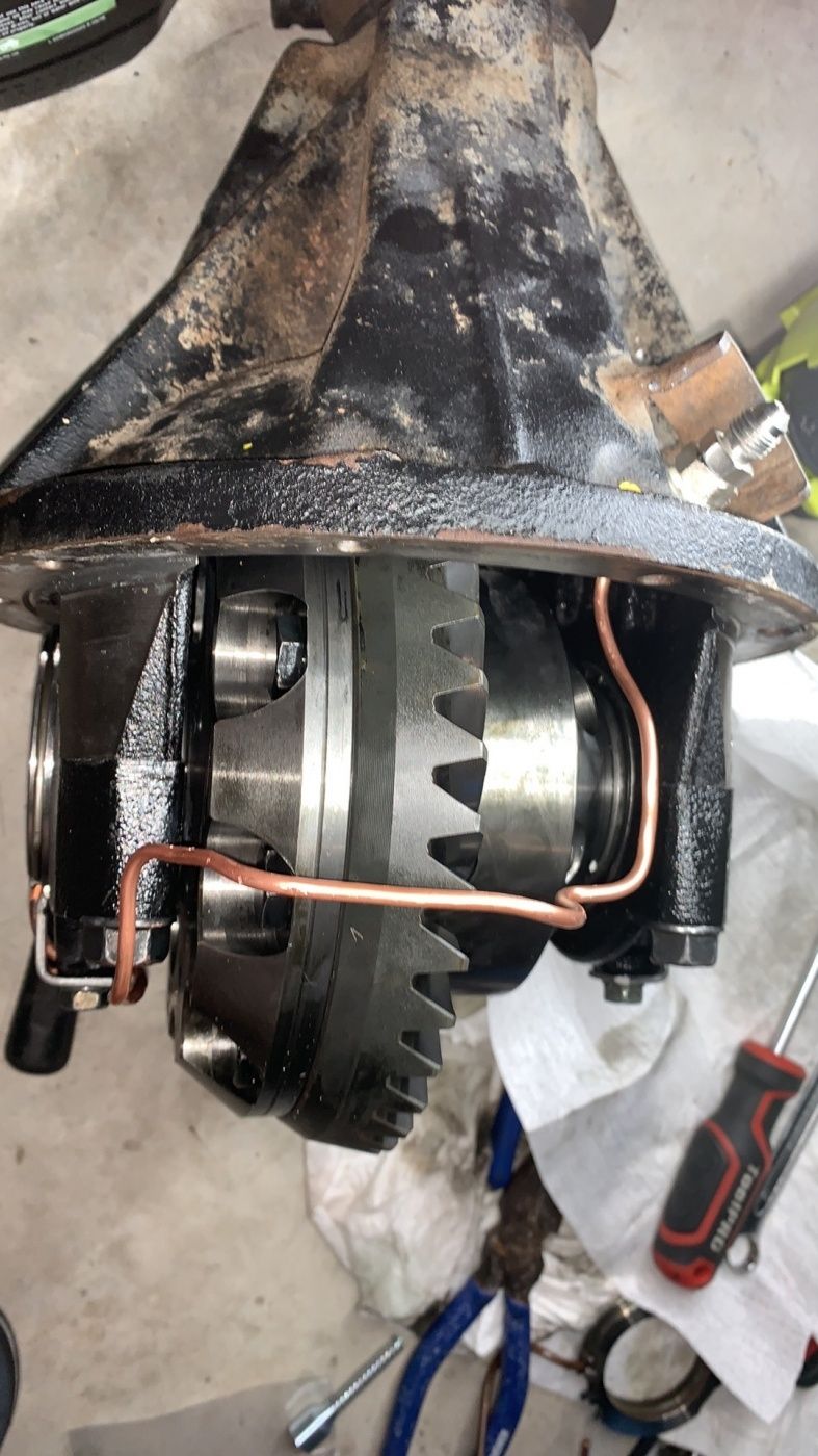

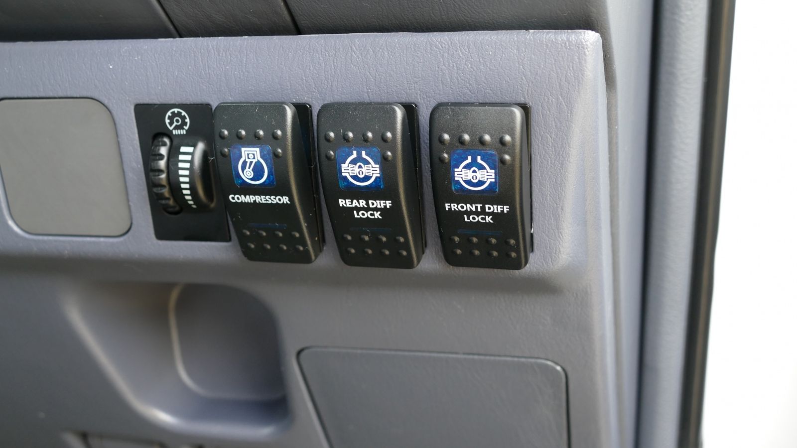

I tossed up keeping it but I like the white more than the green so decided to get all of the goodies out and on sell it on to get some of my cash back. I swapped out both diff centers, extractors and the Supercharger setup with 7th injector and Exede ECU.

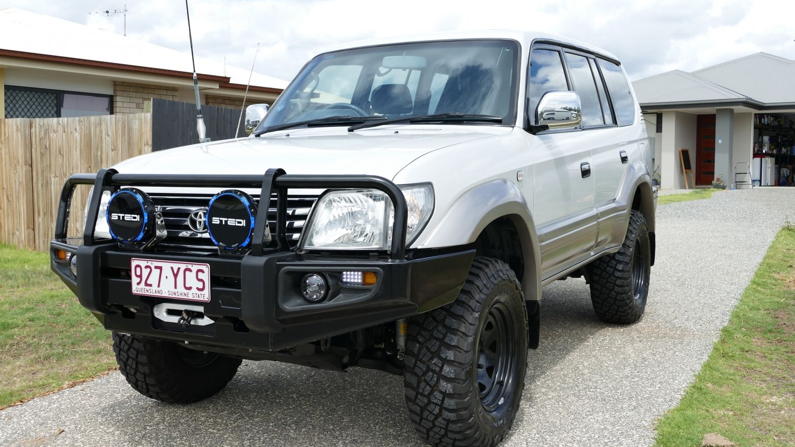

Being left with my White 90 on blocks in the garage the decision was made to go hard and do some other upgrades.
New Pacemaker stainless exhaust system
Installed Supercharger and wired in 7th Injector and Exede ECU
Installed headlights and grill from 2001 Grande with Stedi LED conversion

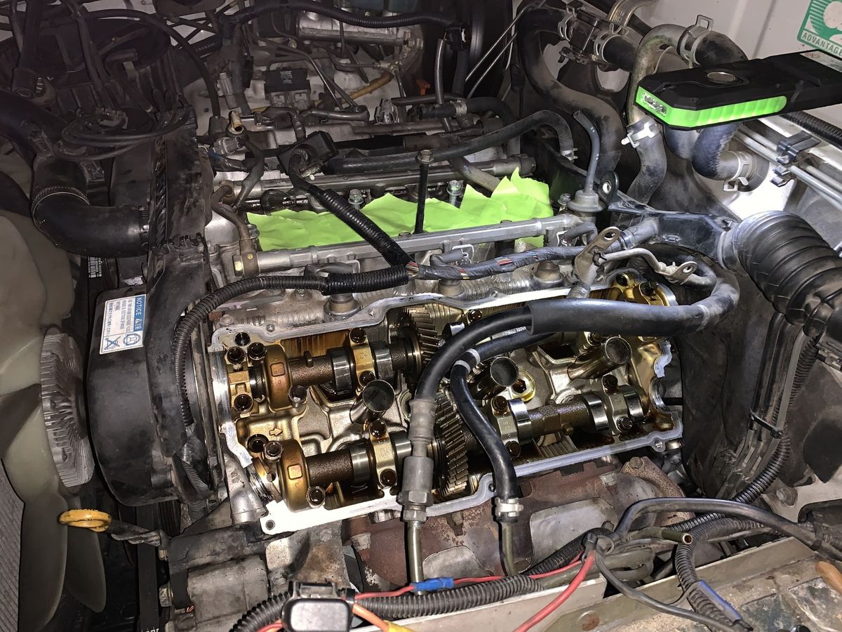

Bought a spare Engine/Auto/transfer case to do all the fitting up in my garage, supposedly the engine was running but after cleaning it up it looks like its had a hit in the front and cracked the cam wheels / cam sensor. Pulled the rockers and doesn't look it has run in years, completely dry top end and half of the valves are stuck open. I actually helped take it out of the vehicle and the front end looked really clean, I suspect the front hit had been repaired and they could not get it running. I have since stripped the auto which was in decent shape, full rebuild, new seal kit, kevlar clutches and bands HD2 shift kit with accumulator springs, rebuilt valve body with genuine parts and got the torque converter rebuilt. The new auto is waiting to go but my current box decided it will work fine now so will leave it in till it dies.
