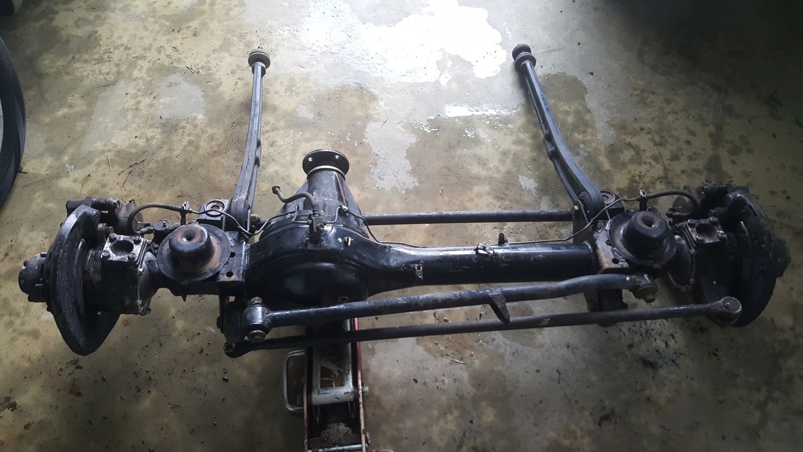

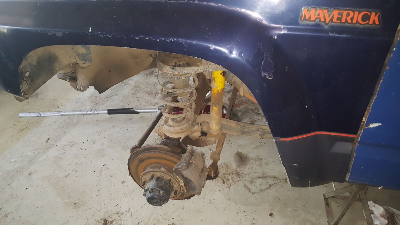

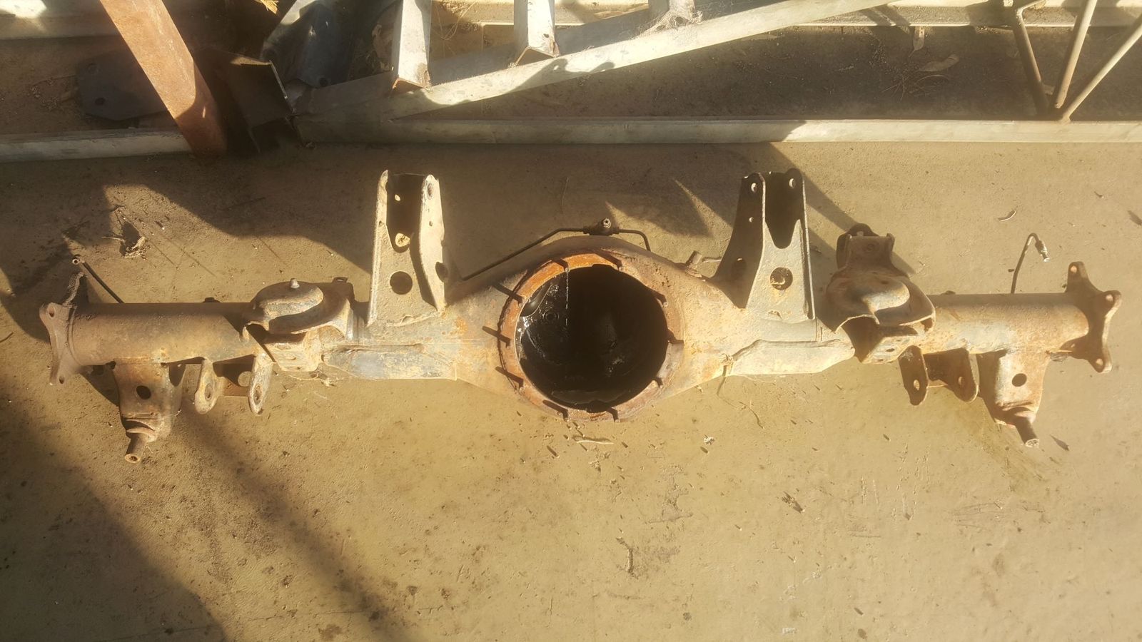

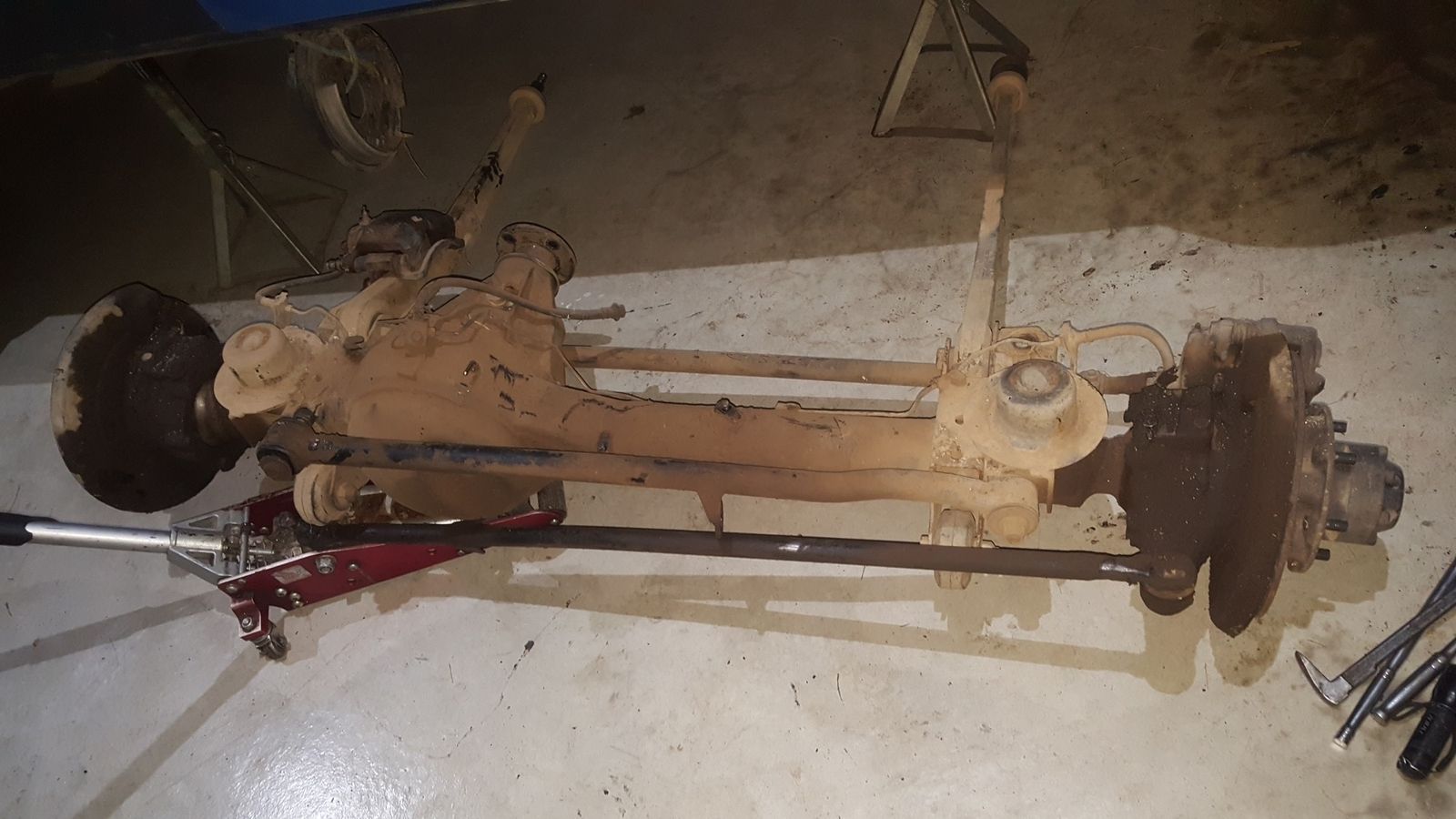

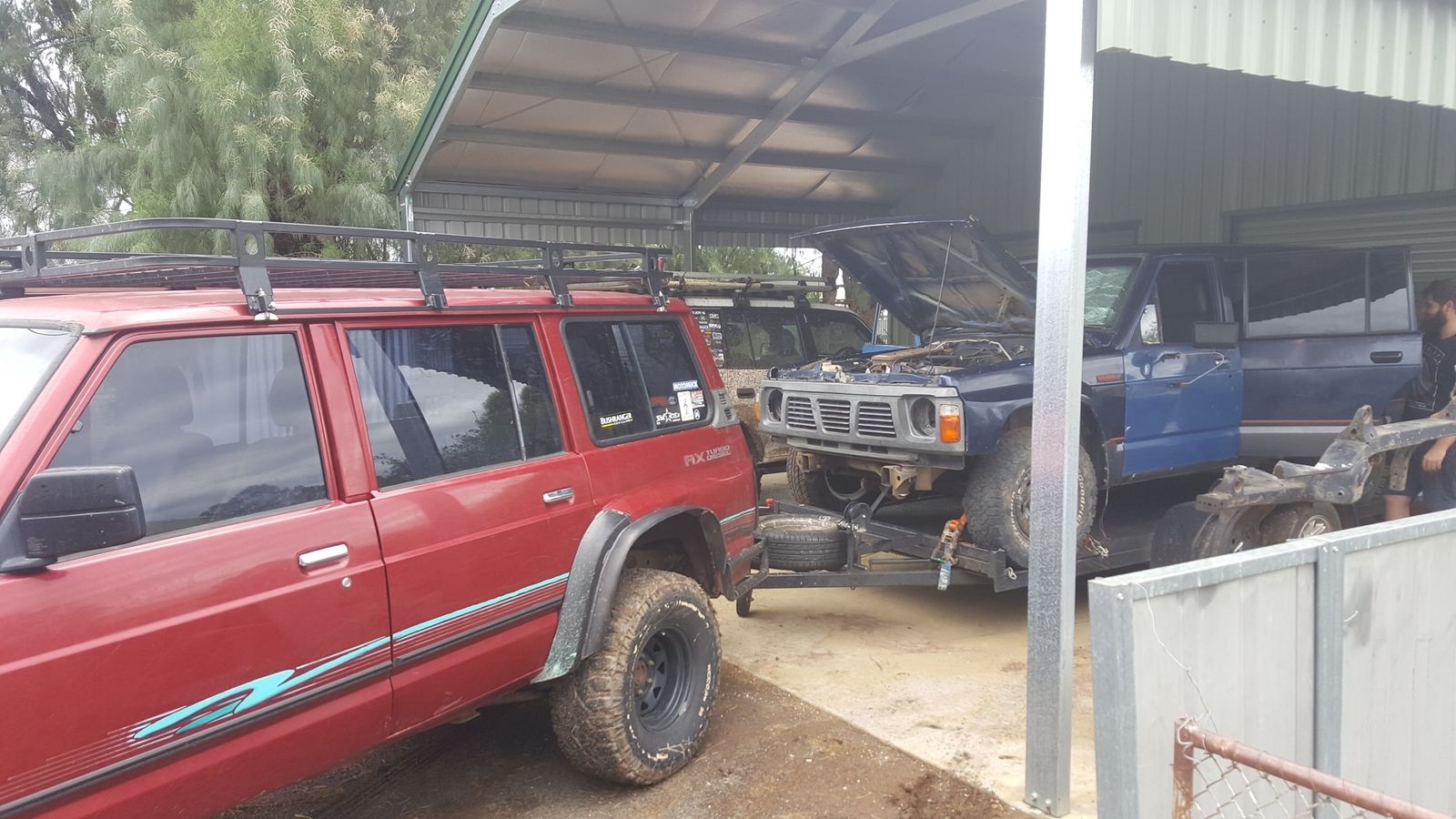

  • Ford Maverick for the donor parts

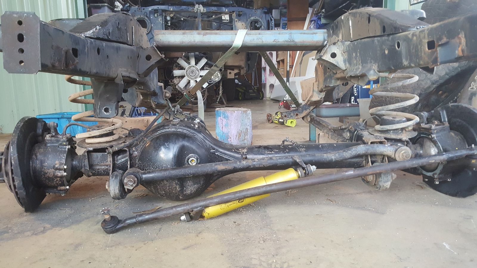

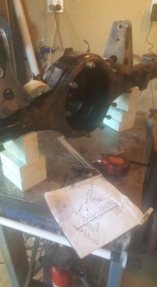

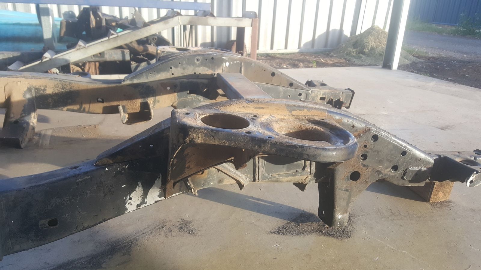

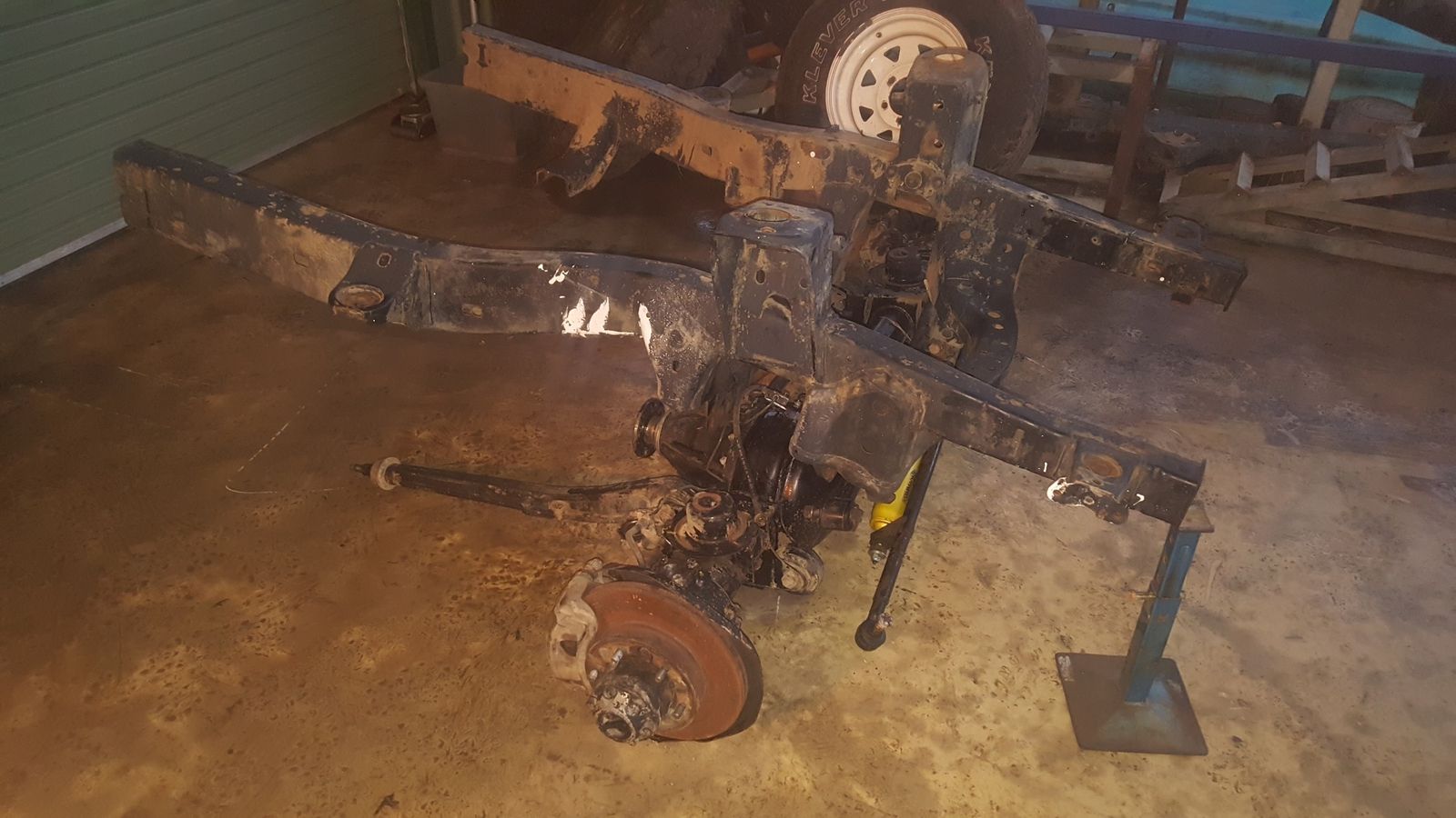

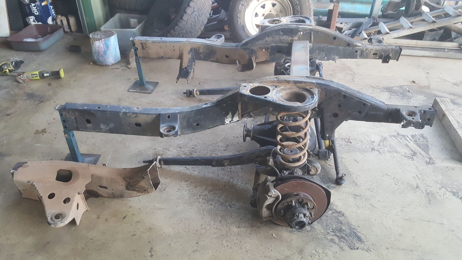

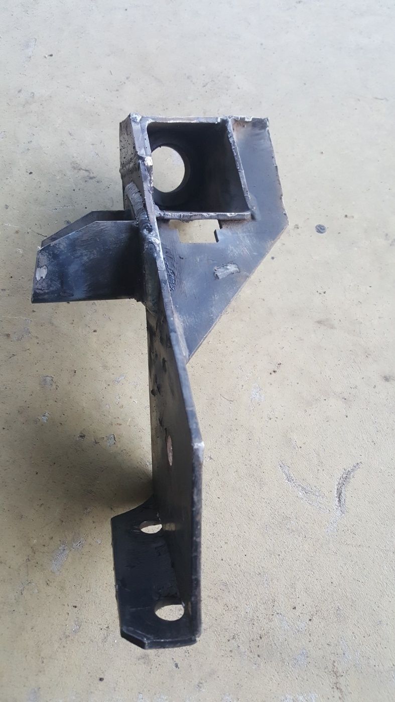

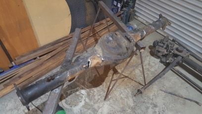

  • I spent a lot of time measuring and trying to work out how to meld the two cars together

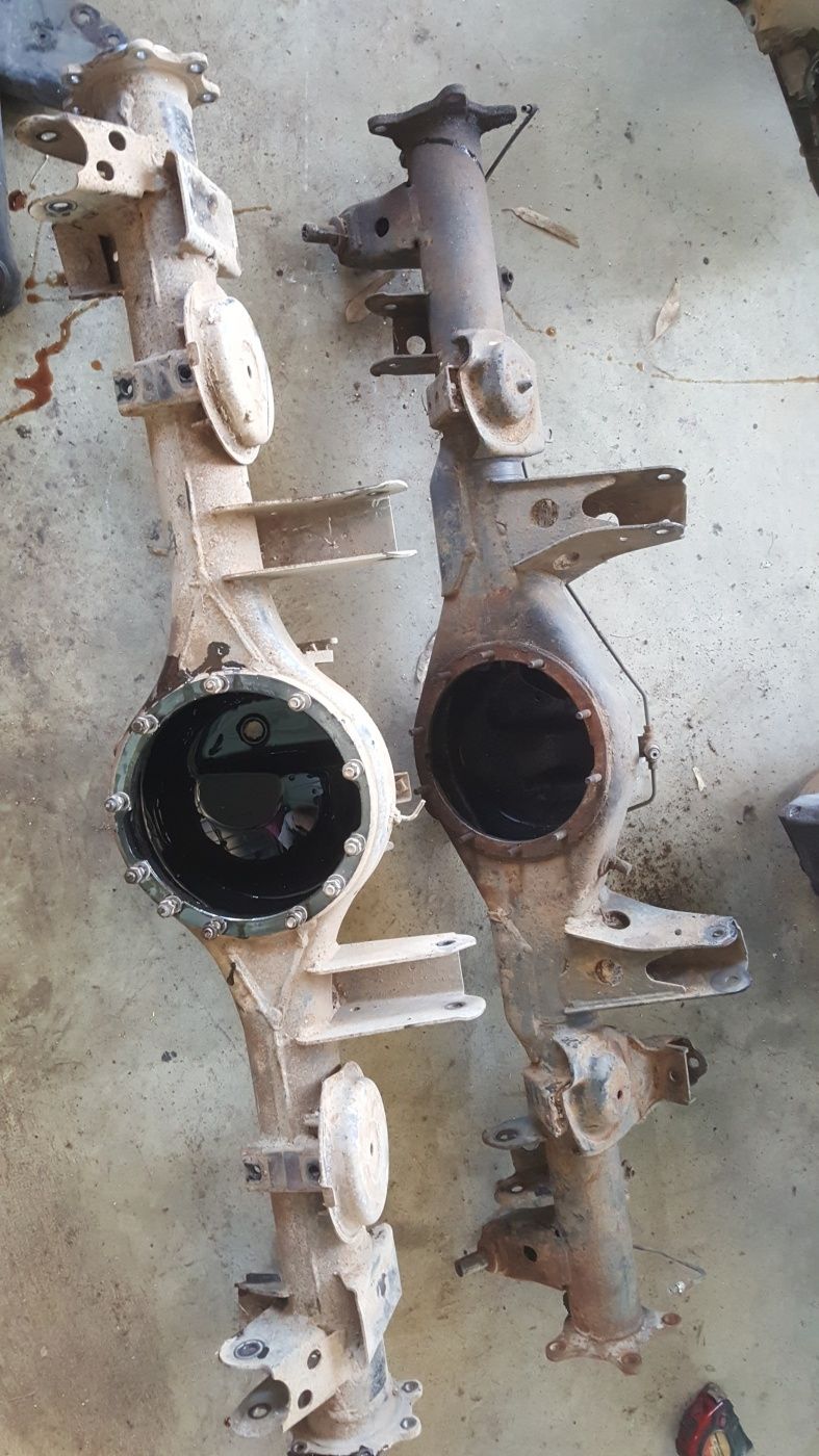

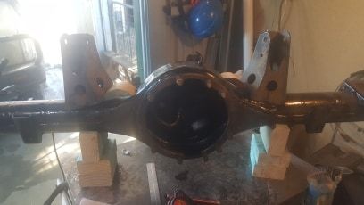

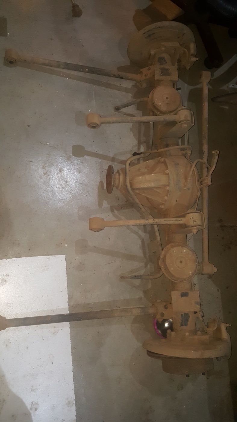

  • One of the strongest and readily available diffs around.

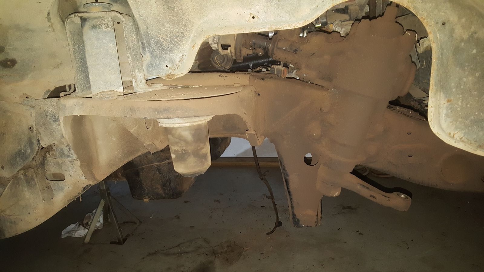

  • Working out things like what steering box to use and ended up going with the standard Mav/Gq box in its stock configuration (I may need to change the hydraulics around later though i'm confident this setup will transfer pretty well)

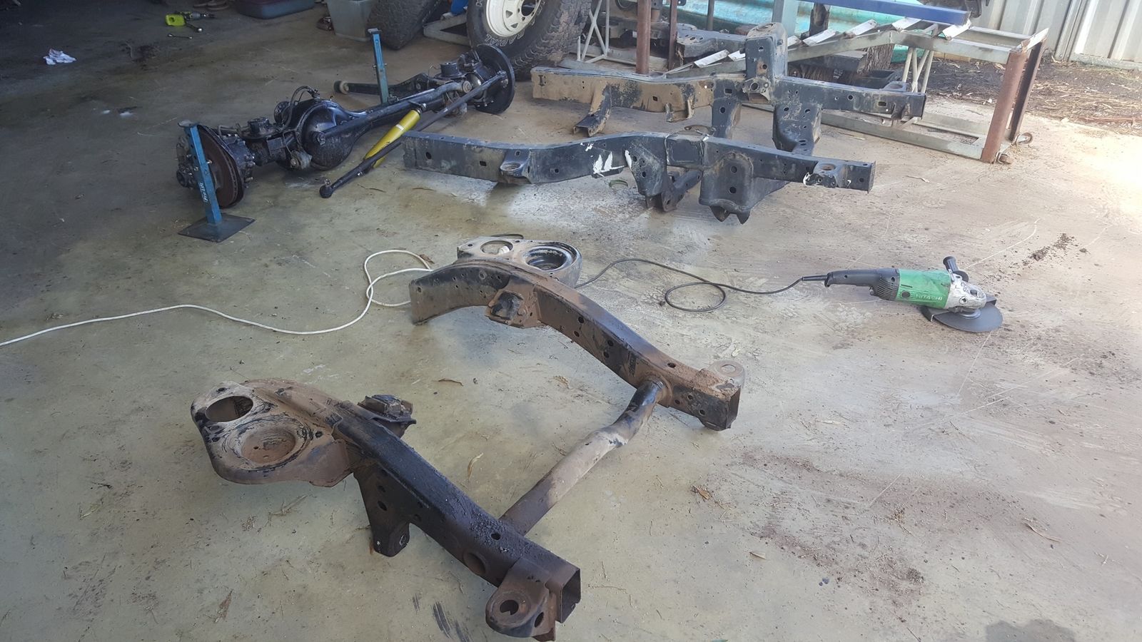

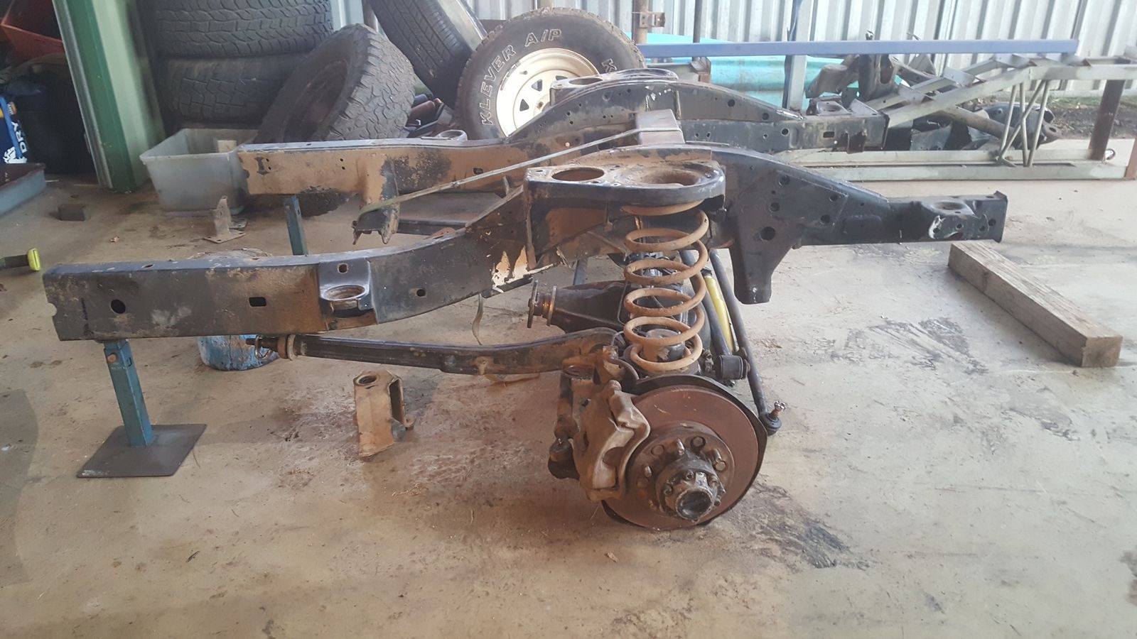

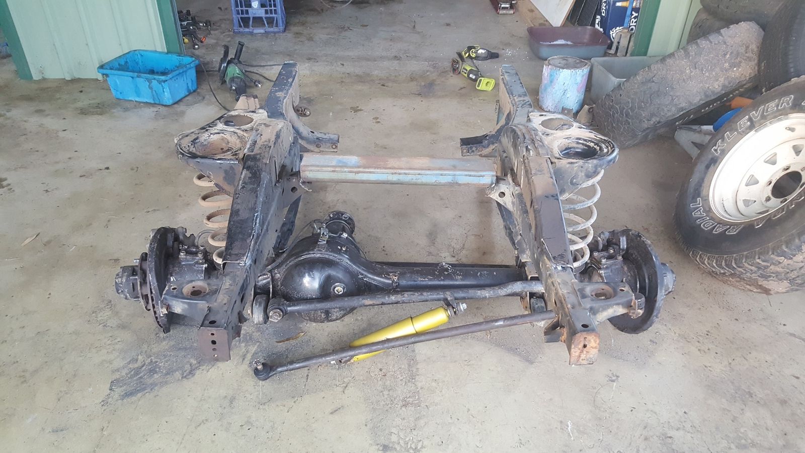

  • I bought a spare Prado chassis to play around with as my Prado is still my daily.

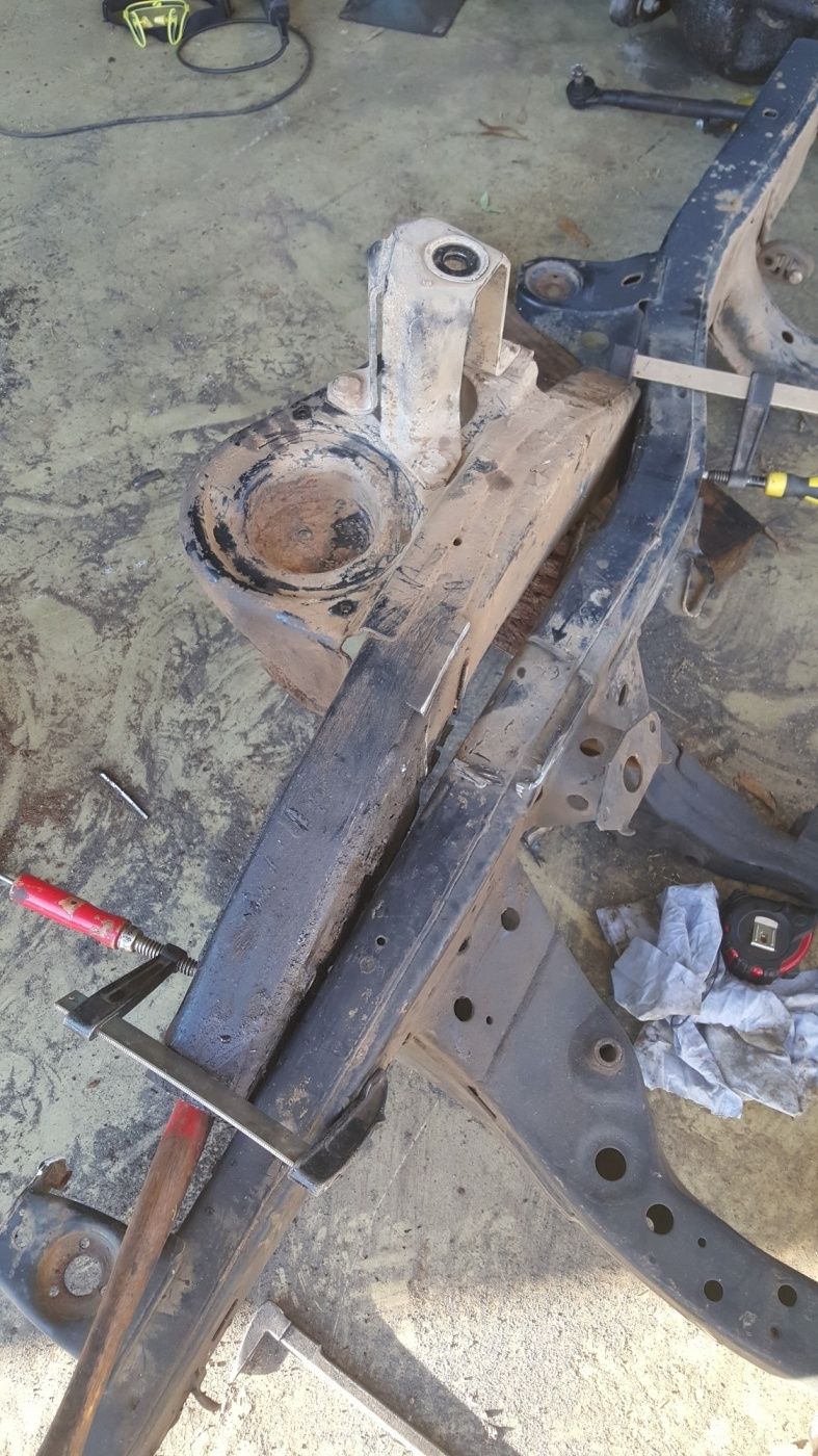

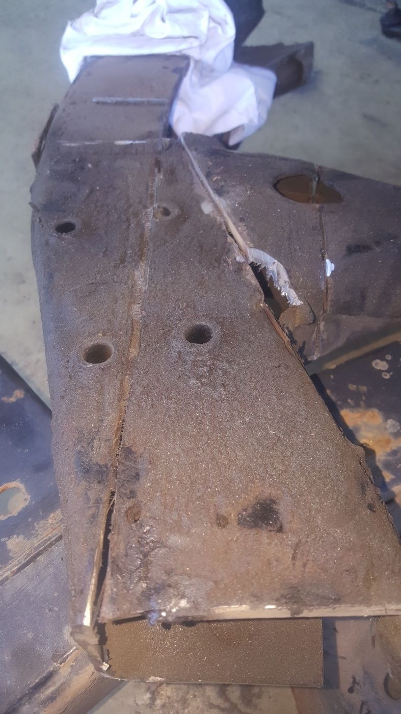

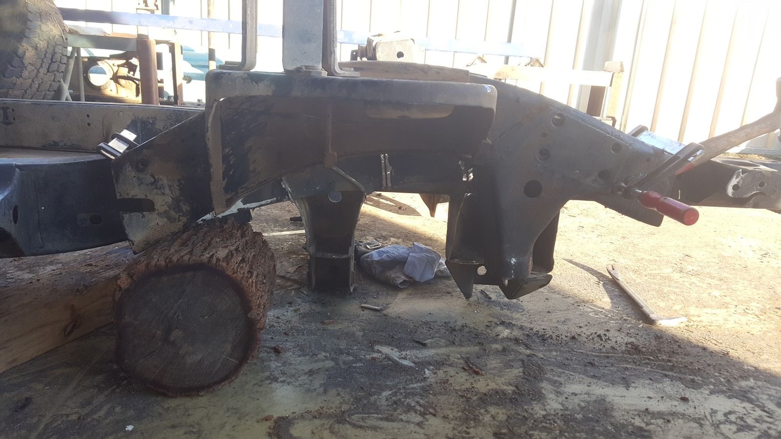

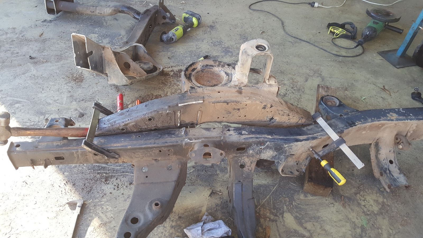

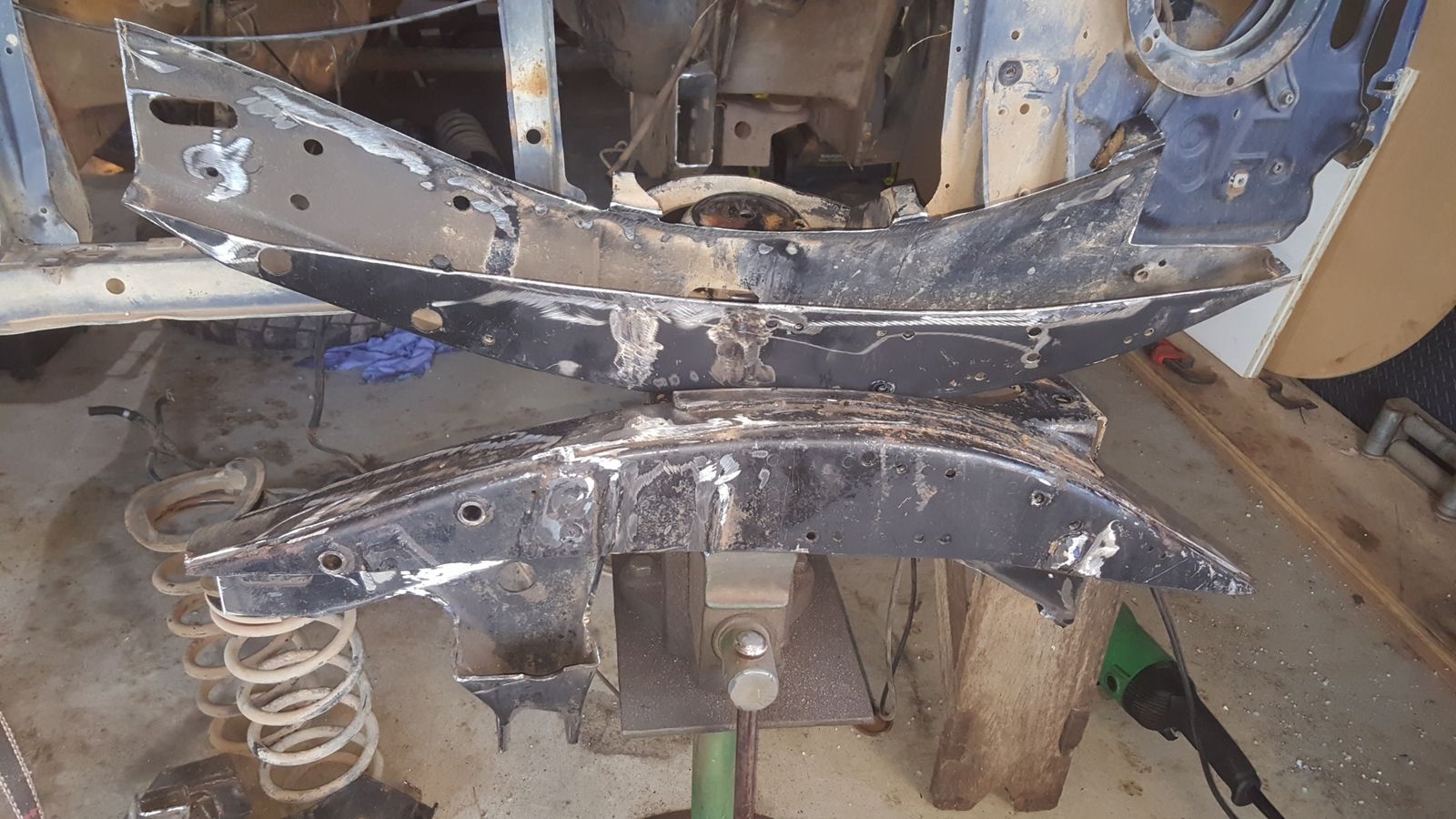

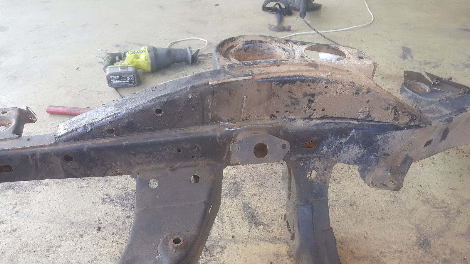

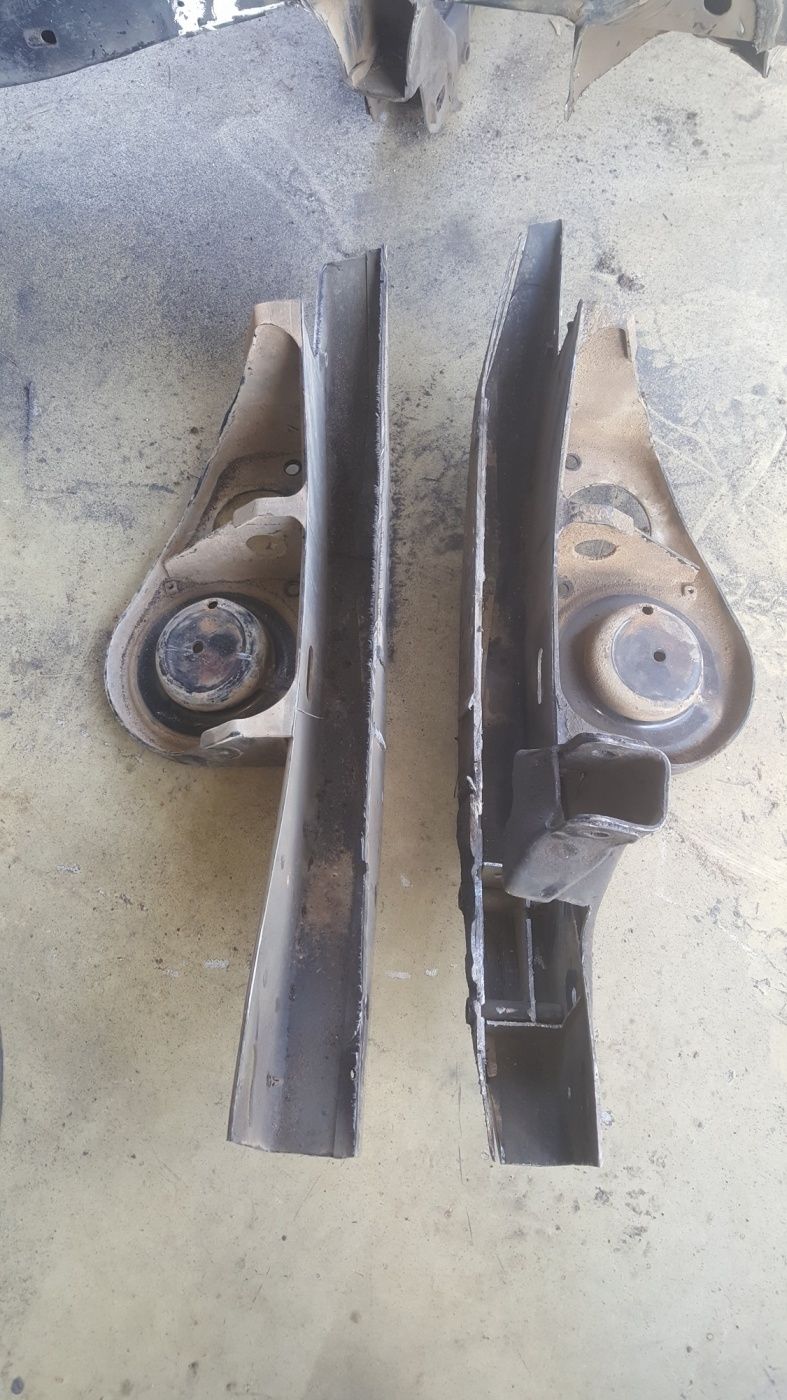

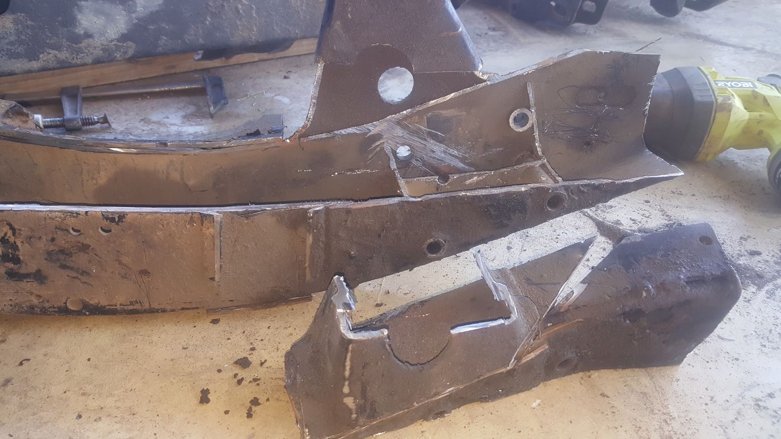

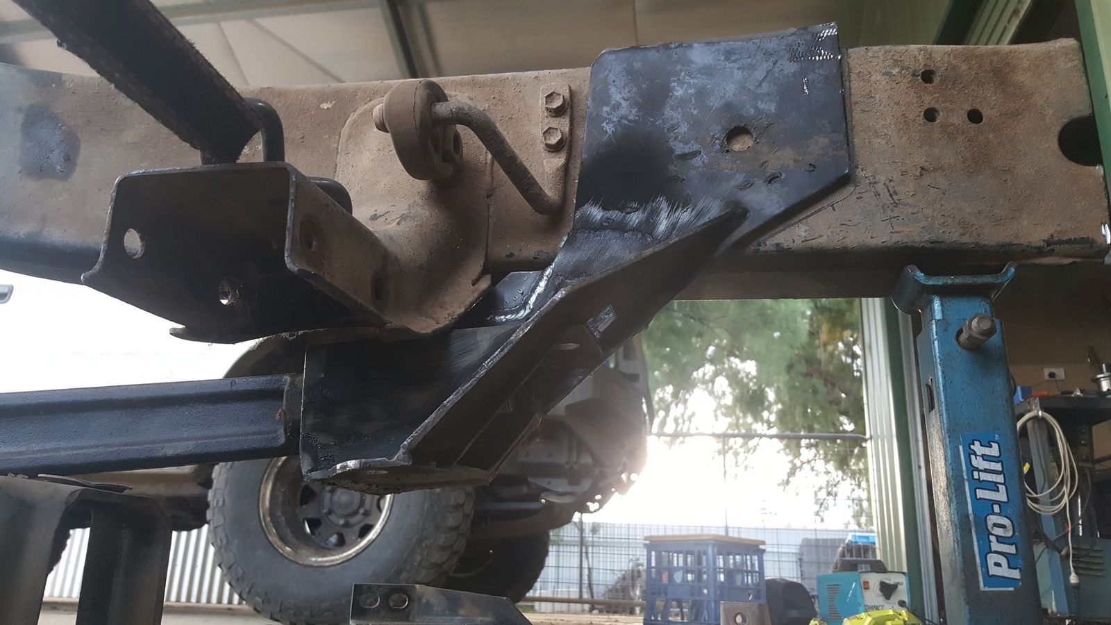

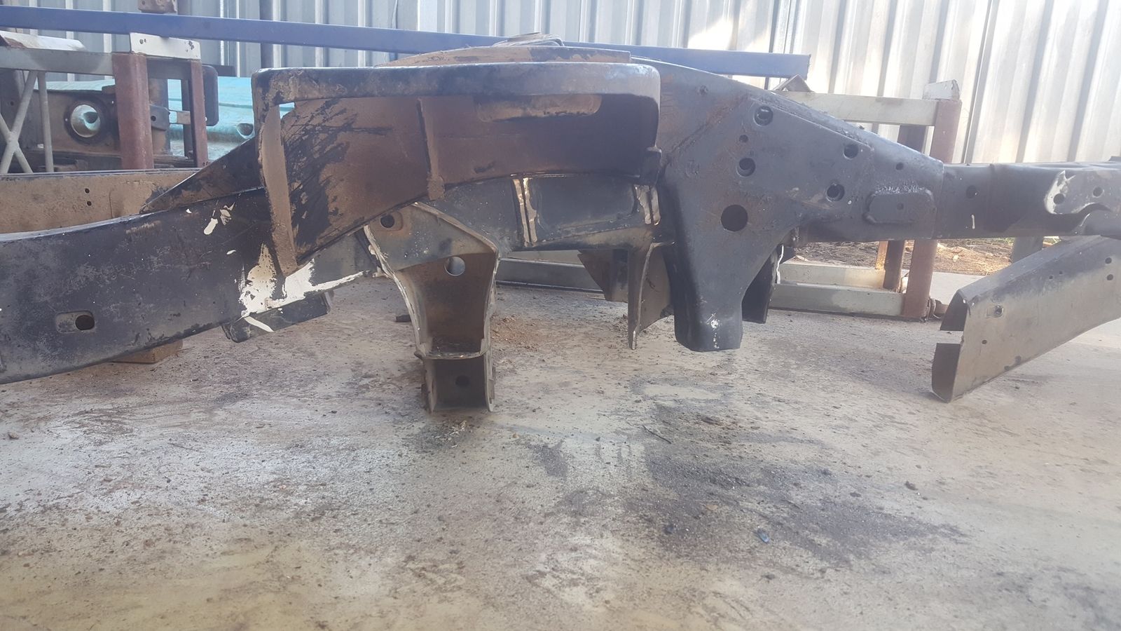

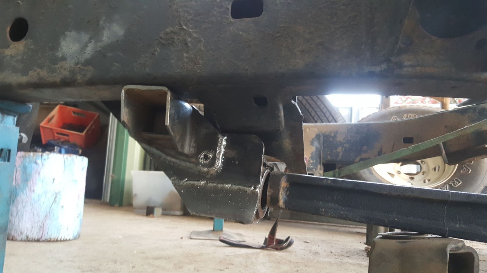

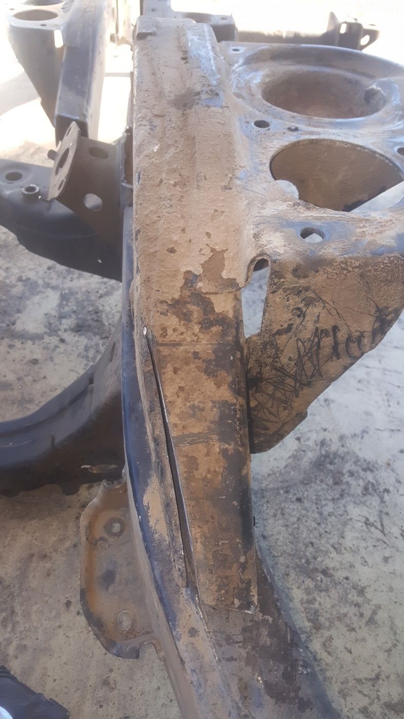

  • Finally getting some cutting done as I begin to work out how and where to join the two up in the strongest way while maintaining all the geometry
